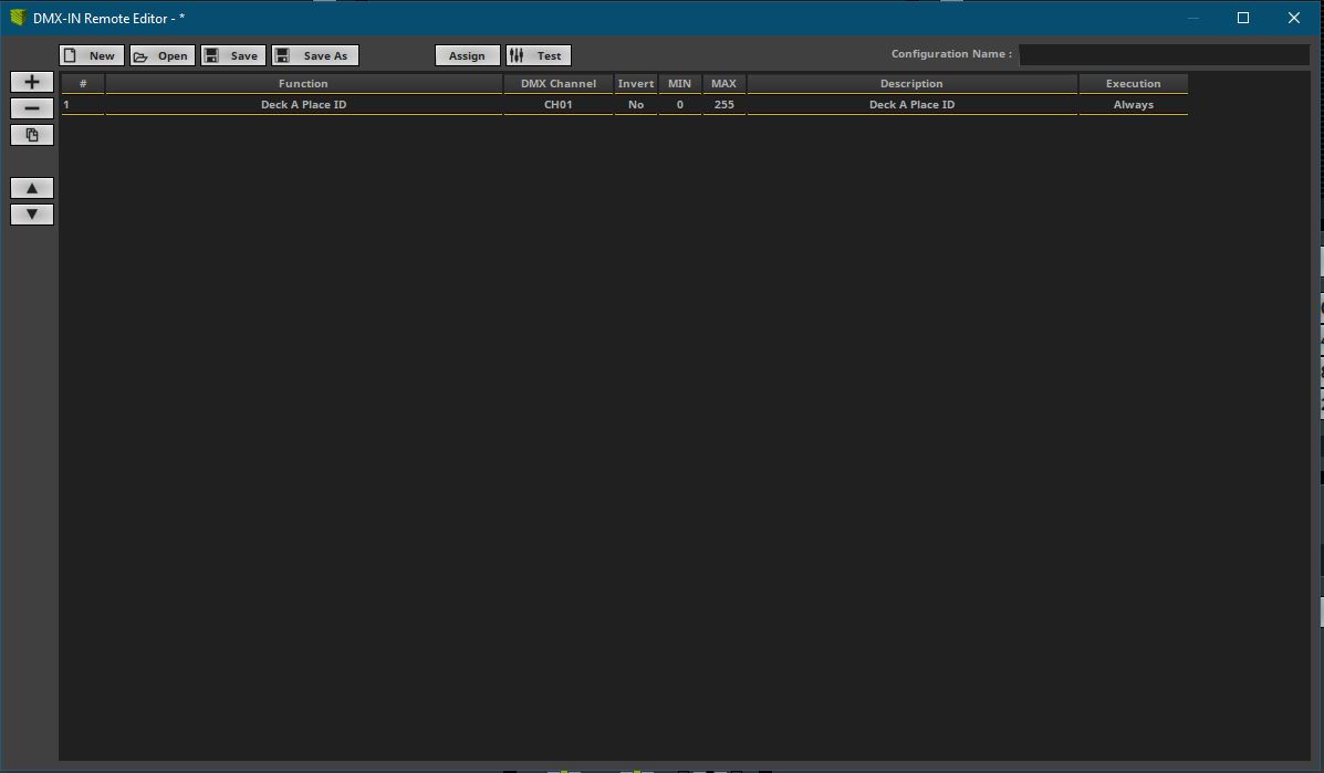

Re: Mapping Orion Switch(es) to trigger S1P1 (for eg) via Artnet
Hi Shulze,
I just got my Orion and have configured as per the attached link to screenshot https://microngroup-my.sharepoint.com/: ... g?e=2JCsVw
- Can you please tell me if this is correct ?
Thank you.
Thank you.

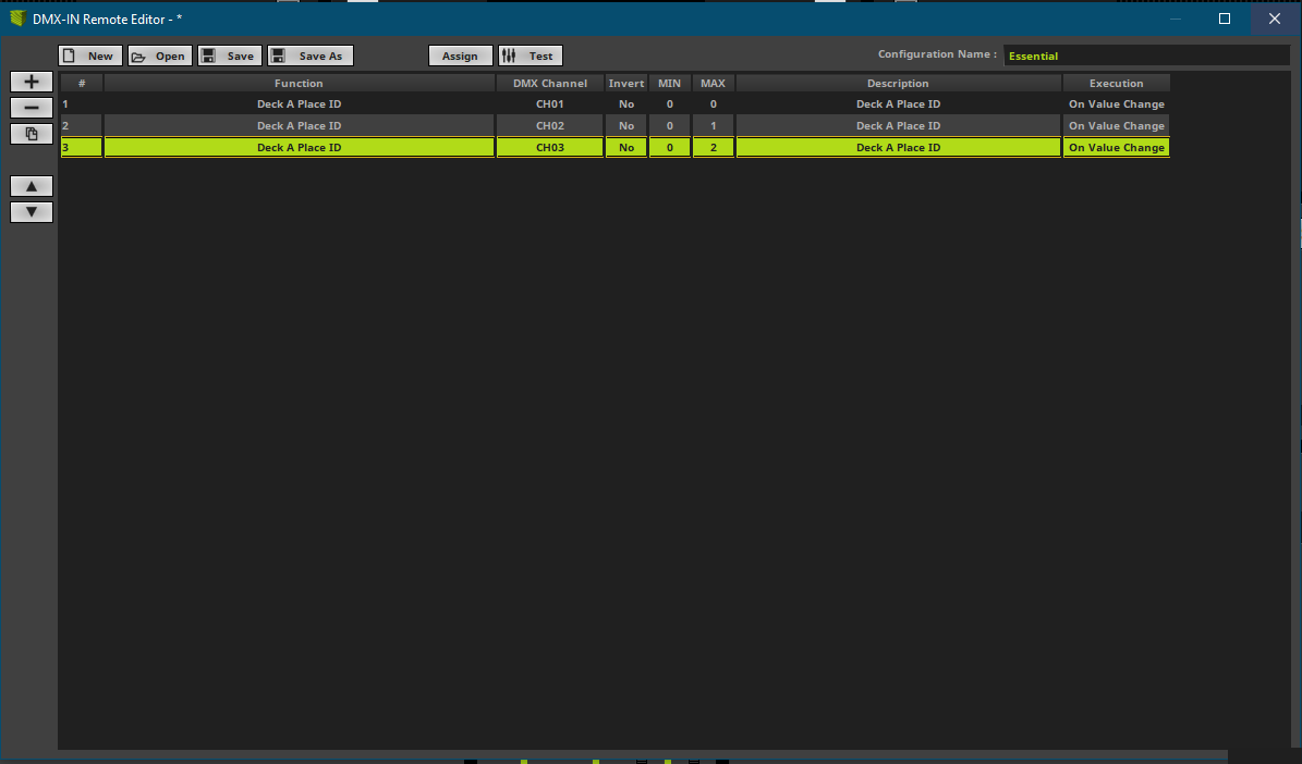

Hi andrewpsyc,
You need to assign different DMX channels for each Storage Place.
- DMX_Remote.PNG (29.23 KiB) Viewed 66473 times

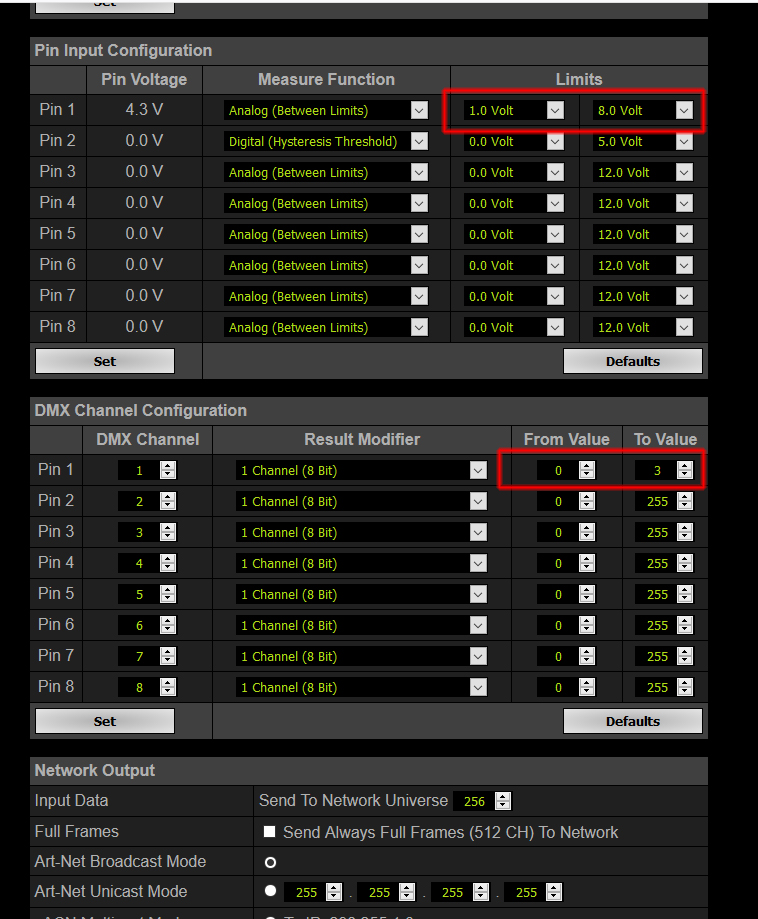

Hi andrewpsyc,
The easiest way would be to use different pins for each Storage Place.
If you want to trigger the Storage Places via a single pin (for example with a potentiometer) you will need to adjust the voltage limit and the DMX value range in the web configuration page.
Adjusting the voltage limit may be tricky, but you can find out the correct limits by try and error.
In the attached screenshot (ORION_Limit_Settings.jpg) you can see a examplary configuration to trigger Storage Place 1 to 4:
- I adjusted the voltage limits by trying out different values.
- I have set the DMX value from 0 to 3 in order to trigger Storage Place 1 to 4.
- In my example I created a new DMX-IN Configuration in MADRIX 5. The "Function" is "Deck A Place ID" and I entered "255" as MAX value and I left the MIN value at 0. (see screenshot "DMX-IN config.jpg")
I hope this helps you.
