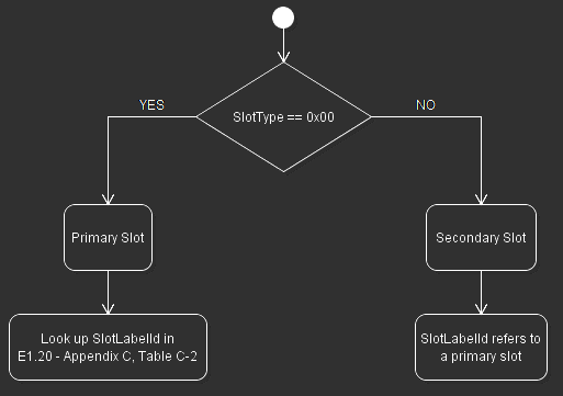

2) The SlotType for the Slot 0x0001 is ST_SEC_FINE (E1.20 - Appendix C, Table C-1). Note that the SlotLabelId 3) is therefore not interpreted as a SlotLabel from E1.20 - Appendix C, Table C-2, but refers to another offset instead, which is 0x0000, the first slot.
4) The SlotType for SlotOffset 0x0003 is ST_SEC_SPEED, which defines this slot as a secondary slot (please refer to 2) ). The SlotLabelId 5) therefore refers to another slot, not the SlotLabelId from E1.20 - Appendix C, Table C-2.
7) The SlotLabelId for this Slot is used, therefore SlotType 6) must be a primary slot (0x00).

9) Due to the 16 bits SlotLabelId being displayed, the SlotType 8) can only be 0x00. This declares this slot as a primary slot. Therefore the SlotLabelId 9) 0x005e is referred to in E1.20 - Appendix C, Table C-2, but 0x005e is not defined there.
In this case MADRIX RADAR displays the "Invalid" text, but also looks up the group of the SlotLabelId which is (0x005e & 0xff00). The resulting value of 0x0000 refers to the Intensity Functions group. Therefore you can see the text "Invalid (Intensity Function)" in this field.
I attached you this image to make the logic behind the SlotLabelId clearer:
