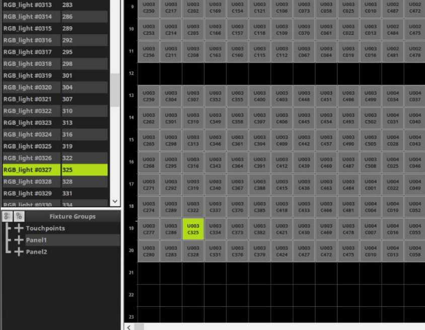

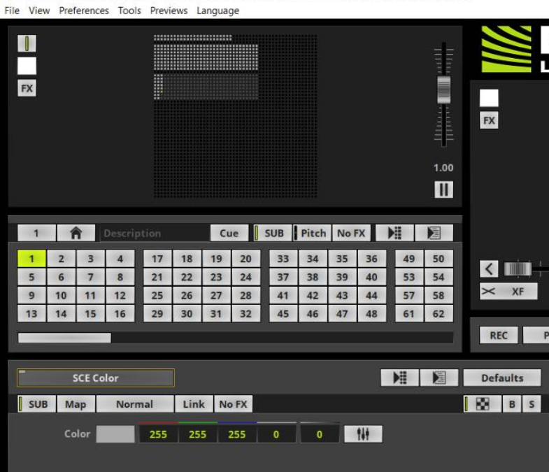

I've successfully added and controlled fixtures through the Patch Editor. However, at some amount of Pixels, I can see that some of them are not actively written through DMX, and they are shown very dim in the Preview window. The first "inactive" Pixel (U3-C325) is not at a Universe Boundary, as you can see in one of the screenshots attached.
In the preview screenshot, you can see the dim representation of these Pixels.

Re: Some Pixels are inactive and not controlled
Hello beartronics,
Welcome to the MADRIX forum.
In the sent screen shot the amount of patched pixels is higher than the connected MADRIX license will unlock.
If too many fixtures are patched respectively the DMX channel amount is higher than the connected license will unlock, these fixtures are dimmed displayed.
To unlock all pachted fixtures please contact your MADRIX dealer to upgrade the MADRIX license.
