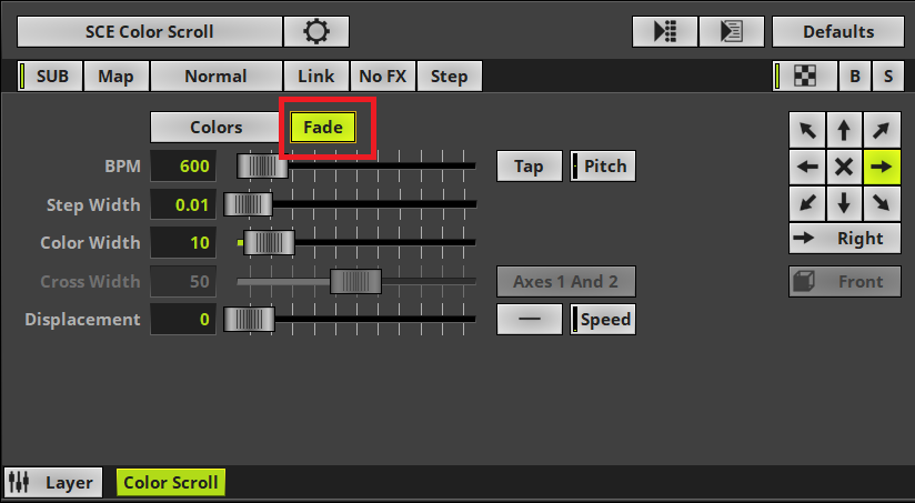

Hi everyone,
I am very new to madrix and I was wondering if it is possible to have the SCE Color Scroll effect fade between the set colors instead of hard cutting.
And if not, is there any other way to achieve a similar result?
Thanks in advance for your help.

Hi LABSTORM,
Just activate the "Fade" option, which can be found right next to the color table.
- SCE Color Scroll with Fade.png (62.92 KiB) Viewed 1493 times
