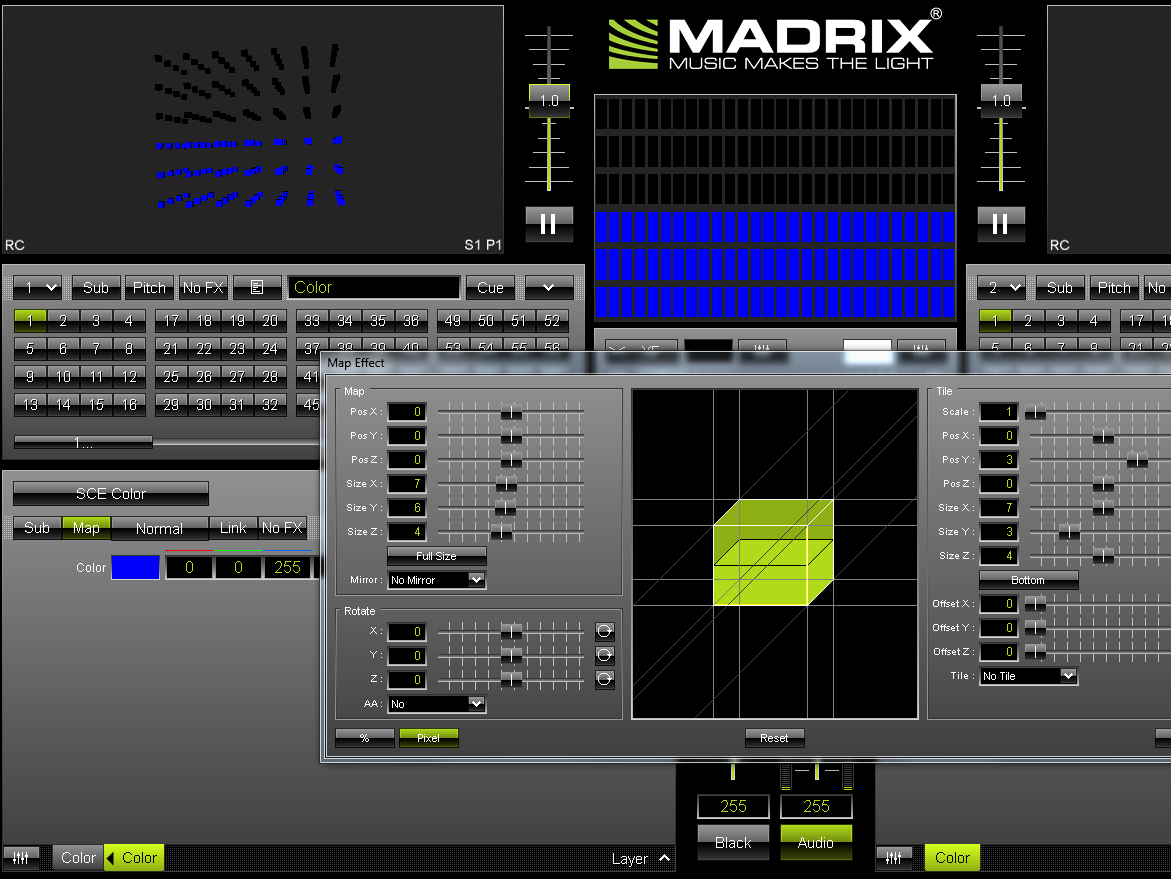

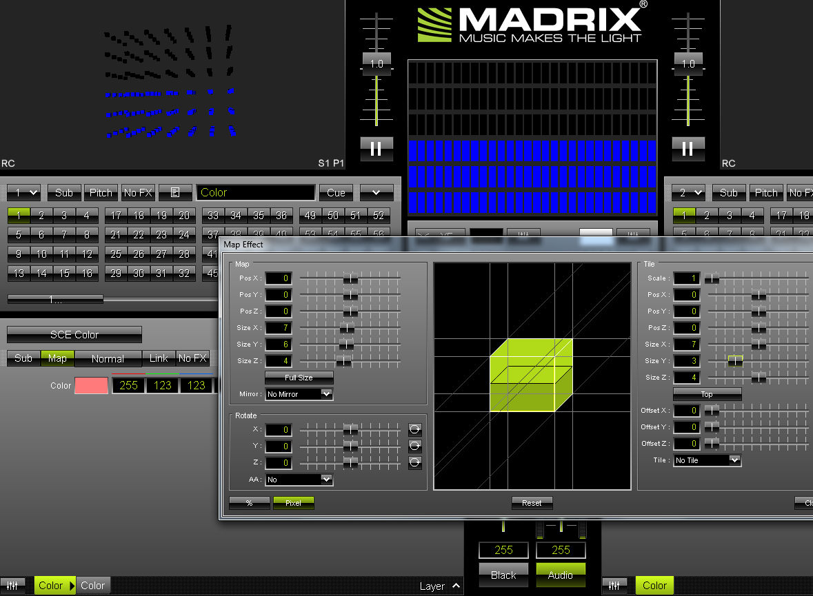

Here's a quick one and easy to replicate (at least with a 3D setup)
If I map the top layer by scaling it to 50% on the y, it does't let the layers below show, instead filling the areas that should be transparent with black.
I want to map half an area with 1 layer and the other half with another layer.
Thanks,
Nathan
Thanks,
Nathan

Hi Nathan,
Can you please double-check the settings.
You were adjusting the values in the "Tile" section (right). Whereas you meant to adjust them in the "Map" section (left). When done in the Map section, I have no trouble displaying two different effects on the top and lower half.
Thanks!
Thanks!
