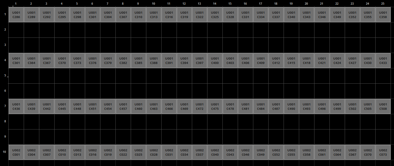

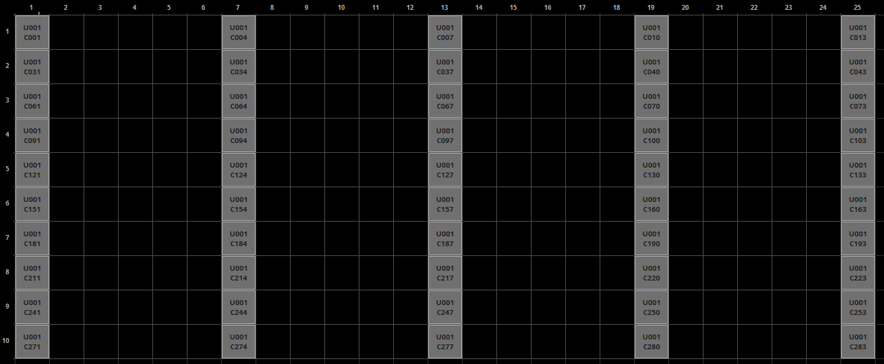

Unfortunately it seems that you forgot to add the image. Without further information my idea would be to use two Z-layers, one consisting of the horizontal lines and the other one for the vertical lines.

I stick to my previous post, therefore I recommend to patch all the horizontal lines on the first z-layer and the vertical lines on the second z-layer. I added two screenshots of how the patch might look like.
Thank you for adding the image.
