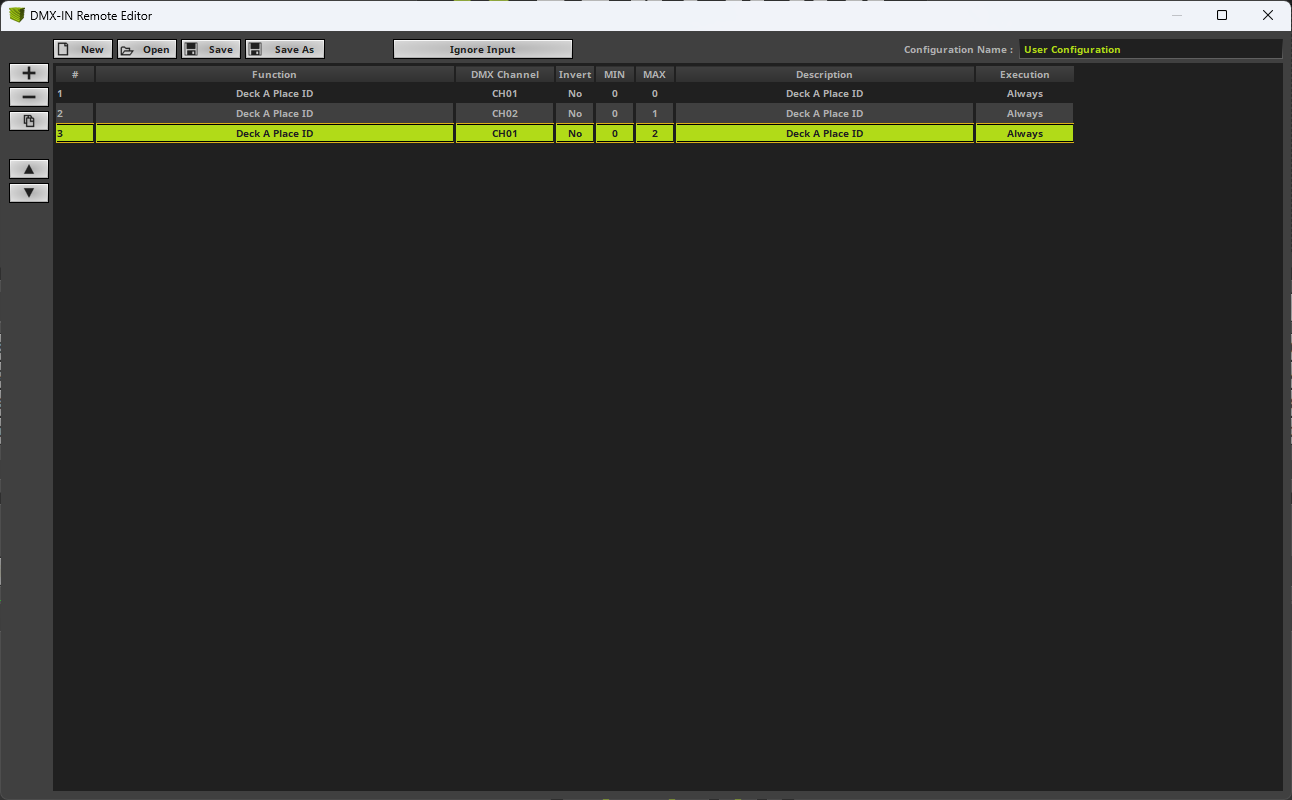

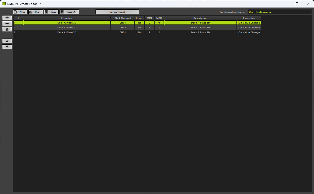

Please find two small configuration examples below:
- In the first example Storage Place 1, 2 and 3 are triggered with three different DMX Channels. I set the "Execution" to "Always". I left the "MIN" value at 0, so that the Storage Places are only activated, if I receive a 255 value on each of those 3 DMX channels. If a 0 is received, Place 1 will be active.
- In the second example Storage 1, 2 and 3 should be also triggered by three different DMX channels. This time I set the "Execution" to "On Value Change", since I also want to have the opportunity to select Storage Places manually in the software. I used the same value for "MIN" and "MAX", so that the triggered Storage Place remains activated.

- Remote_Example_1_Always.png (31.05 KiB) Viewed 3871 times
- Remote_Example_2_OnValueChange.png (31.38 KiB) Viewed 3871 times

That is very helpful. Thank you for your reply. The information I had not been able to find was the fact that the DMX Max level relates to the storage place number. That makes things much clearer.
Can I just clarify that line 3 in your example should be CH03 and not 1?
Thanks again.
Thanks again.
Re: DMX to Trigger Storage Place
Hi cuthbec,
Yes, you are right. I made a little mistake in my example, the third list entry should be assigned to DMX channel 3. Sorry!
