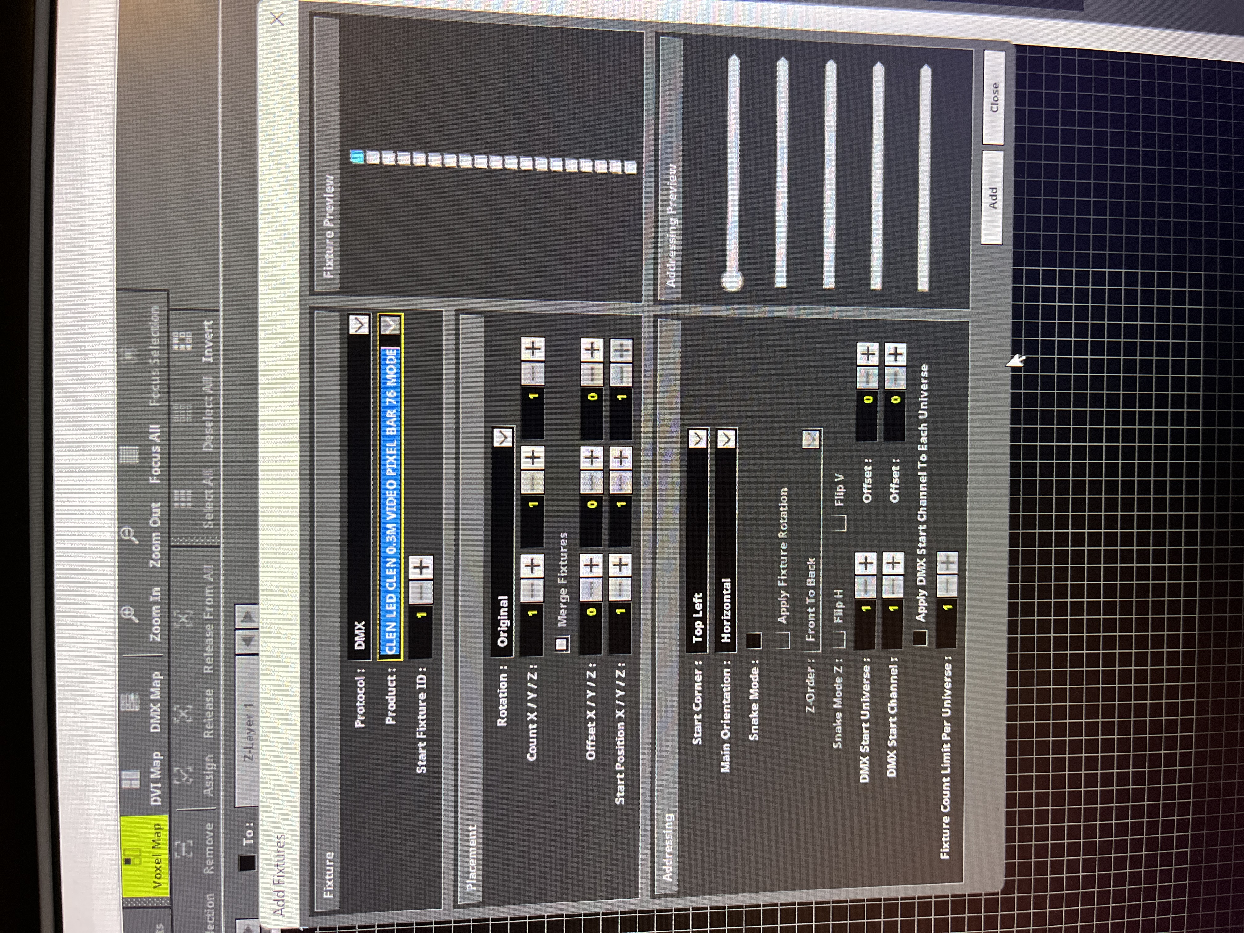

I have created 4 different fixtures in the fixture library and loaded these into madrix. When I come to add them to the patch I am limited to "Fixture Count Limit Per Universe" = 1.
One of the fixtures I have created is 19px, RGBW so it's 76 channels. I should be able to get 6 fixtures per universe.
Usually when I do patch from the standard library "Generic RGBW 1 pixel" it will automatically work out how many fixtures per universe but with this new fixture it automatically defaults to 1 per universe?

- IMG_6223 2.JPG (4.37 MiB) Viewed 3022 times
- IMG_6222 2.JPG (4.63 MiB) Viewed 3022 times

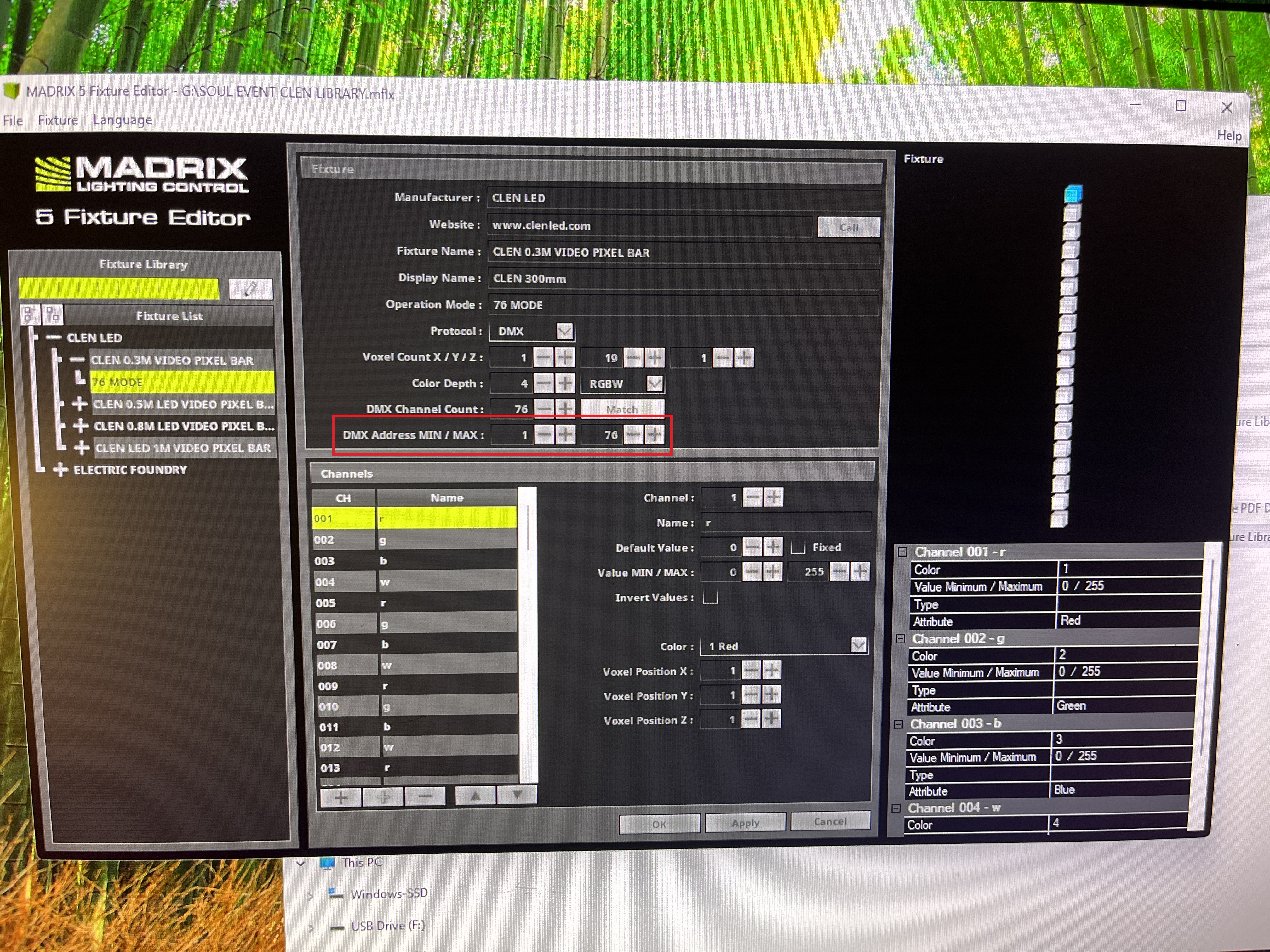

Hi EddL,
This is because "DMX Address MIN / MAX" is set to 1 - 76. Please change the minimum to 1 and the maximum to 512.
Here you will find the setting:
