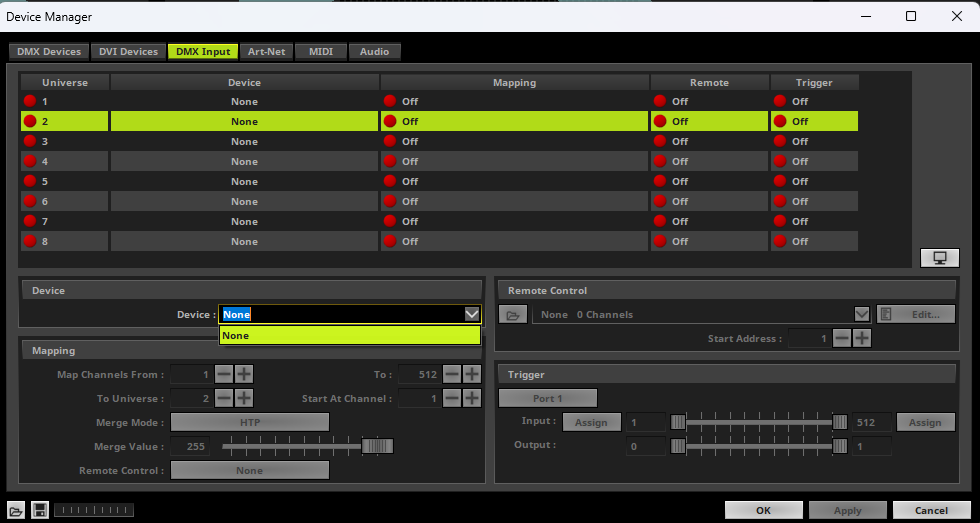

Did you select the sACN device in the "DMX Input" tab?
If not, please navigate to "Preferences" > "Device Manager..." > "DMX Input", click at one of the input universes and select the sACN device. Now you should be able to see incoming sACN data in the DMX Watcher.

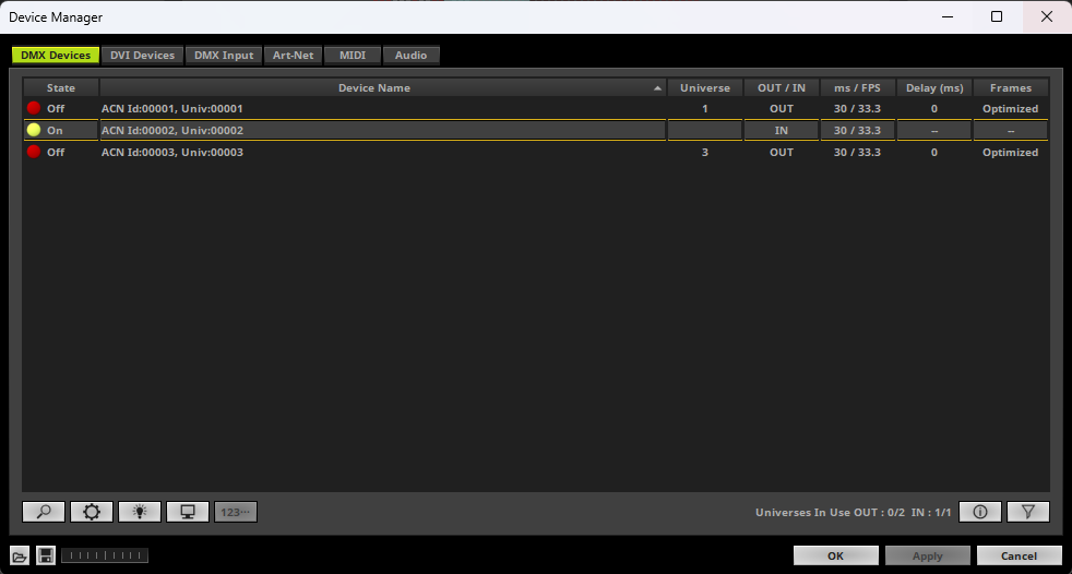

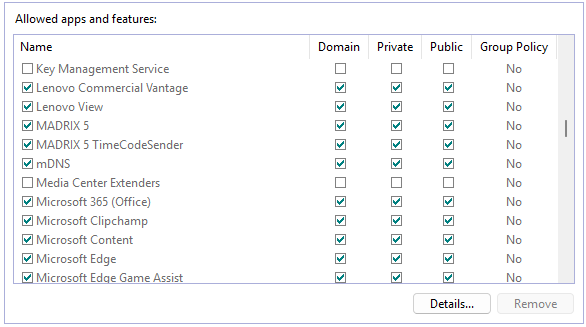

I am unable to see the sACN device. In the Devices Network tab I have Streaming ACN selected and the correct IP address selected from the pull-down menu. Windows Defender doesn't have anything blocking it, and my IT folks made sure there wasn't any other firewalls blocking traffic. I turned on the State for U2 to On, but the Device Name seems so just be a generic name.
- nodmxin.png (59.78 KiB) Viewed 1567 times

- madrixFW.png (16.94 KiB) Viewed 1567 times
