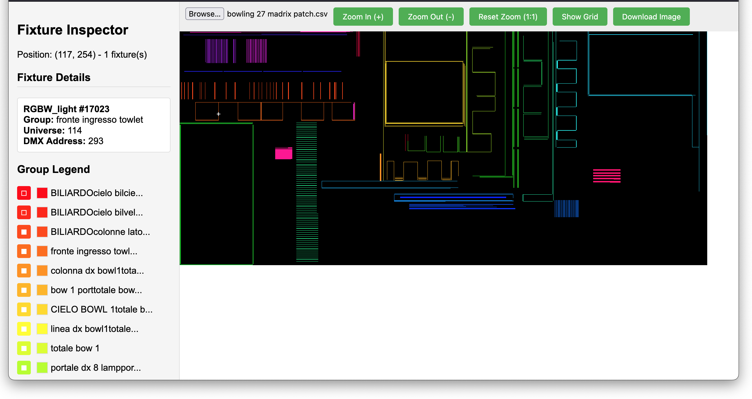

after realising that the patch editor lacks a few important features to help identify groups. i had a play around with deepseek AI building a javascript visualiser for madrix patches.
its pretty basic and buggy, but it has a feature that lets you hide the fixtures belonging to a particular group, which makes it pretty easy to use to figure out what is where:
(its embedded in an html file so you can just load it into your browser, select a csv file and everything happens localy).
remember this was made by AI so beware...

ah, i'd totally missed the select menu! much better..
there still a few more things that are making this painfull.
My workspace is too big to zoom out completely to see and moving around it is pretty uncomfortable. an overview would be handy, that shows a zoomed out image of the whole workspace.
there dosent seem to be a way of moving around the workspace other than using the scroll bars, ( or focus ) keybindings would be nice(wasd?) or being able to drag the workspace around with the mouse.
using the deepseek generated tool to explore the workspace and export a .png i have made a background image with labels on the groups, so i'm on my way to understanding where the unmapped leds are hiding, and where i should be adding the extra ones.
