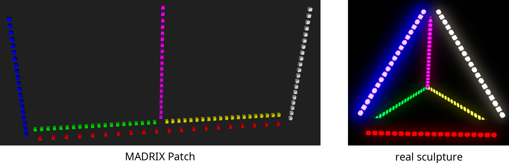

All of the fabrication is completed and we are now trying to figure out how to layout our LED pixels. There are at least 3 different geometries we could isolate and transition between to shift the form of the sculpture. Initially I had planned on 3 data shared strands that originate from the top, but am now thinking that it would be better to have full addressability over the whole sculpture for 3 dimensional radiating effects. Does anyone have any ideas on how to lay these out? We are actively looking for team members for Burning Man 2019 and future events!

When you want to create a patch for this wire frame sculpture, I would recommend to split the complex sculpture in different parts and unfold the parts to lines. Now you can patch this lines in MADRIX and you can create cool, creative effects after you unfold it. Of course the MADRIX preview can't be used like a visualizer. It is now a technical preview to see how the effect is looking in MADRIX.
Attached you will find an example how you could unfold a such a 3D wire frame sculpture and patch it in MADRIX.
The colors of the fixtures in the MADRIX Preview corresponds with the colors of the fixtures at the real sculpture.
As you can see in the image there are two Z-Layers used. At the first Z-Layer the fixtures for the front driangle is patched and at Z-Layer two all other diagonal fixtures which are going in the depth in real are patched.
When you now create some groups for the different parts you are able to map the desired effects to the desired parts very easily.
- SculpturePatch.jpg (243.6 KiB) Viewed 34172 times

Thank you so much for your help!
